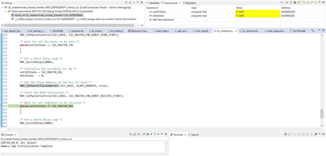

    I have tried using same code as in resource explorer i2c_mastermode_simple_transfer_MSP_EXP432E401Y_nortos_ccs and i2c_slavemode_simple_transfer_MSP_EXP432E401Y_nortos_ccs, with PG0 and PG1 pins for I2C.
    I see no communcation between MCU's.
    While suspending the debug, it is stopping at the below point
    But while checking the same with oscilloscope, SCL is as below but couldn't get any waveform for SDA
  • Some questions:
    - Do you have the pullup resistors on both the SCL and SDA buses?
    - If you run both the master and the slave examples as is without any modification, do you see a difference? If it works as is then it must be something in your modified code for I2C2 that is not properly configured.
  • Internal pull-up resistors have been used.
    Codes for both Master and slave have been used directly from resource explorer for I2C1( i.e., PG0 & PG1).
    You cannot rely on internal pull. You must use external pullup.
