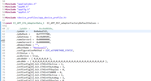

Actually I am developing an GUI for assigning IP addresses for the Ethernet I/P(EIP)  module (AM2434 used for EIP Development) we have set static IP address in appRst.c file  . How can we change this IP address, subnet , gateway by connecting AM2434 through LAN ??
We are trying to evaluate LP-AM243 for EtherNet/IP adapter using industrial communication SDK as mentioned in the link below–( ind_comms_sdk_am243x_09_00_00_03)
https://dev.ti.com/tirex/explore/node?node=A__AD2nw6Uu4txAz2eqZdShBg__INDUSTRIAL-COMMUNICATIONS-SDK-AM243X__P--DGtH__LATEST
how the backend part works for assigning IP addresses through LAN Cable ??
The following changes are made in the in appRst.c file

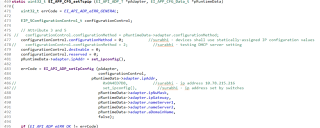

the following changes are made in appCfg.c file (configuration method is 0)
can you also specify about changing of IP through CLI(command line interface)??
