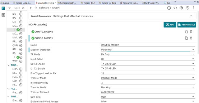

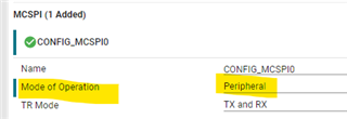

Hi Team,
I am using this TMDSCNCD263 board and this is the IO Extender TMDSHSECDOCK.
I am having one requirement, have 2 controllers one is AM2634 and second one is STM32 Nucleo Board i need to configure AM2534 board as a Master and STM32 as a Slave Now i have to transfer data from Master to slave and receive data from salve to master
I write down one code but not working can anyone help me to figure out what's the issue
AM2634 (Master Code)

/* Initiate transfer */
MCSPI_Transaction_init(&spiTransaction);
spiTransaction.channel = gConfigMcspi0ChCfg[0].chNum; // SPI0 as transmitter
spiTransaction.dataSize = 8;
spiTransaction.csDisable = TRUE;
spiTransaction.count = APP_MCSPI_MSGSIZE / (spiTransaction.dataSize/8);
spiTransaction.txBuf = (void *)gMcspiTxBuffer;
spiTransaction.rxBuf = NULL; // No need to receive on SPI0
spiTransaction.args = NULL;
startTimeInUSec = ClockP_getTimeUsec();
for(j = 0U; j < APP_MCSPI_TRANSFER_LOOPCOUNT; j++)
transferOK = MCSPI_transfer(gMcspiHandle[CONFIG_MCSPI0], &spiTransaction);

// Now, receive data on SPI1
spiTransaction.channel = gConfigMcspi1ChCfg[0].chNum; // SPI1 as receiver
spiTransaction.txBuf = NULL; // No need to transmit on SPI1
spiTransaction.rxBuf = (void *)gMcspiRxBuffer;
transferOK = MCSPI_transfer(gMcspiHandle[CONFIG_MCSPI1], &spiTransaction);
if(SystemP_SUCCESS != transferOK)
DebugP_assert(FALSE); /* MCSPI transfer failed!! */

  • Hi Swati,
    In SysConfig GUI, please select "Peripheral" for Mode of Operation:
  • Hi QJ Wang
    I did the same configuration for slave
    AIM: My aim is SPI0(Master) of AM2634 send data to STM32 SPI1(Slave), once STM32 SPI1 receives data it revert response to AM2634 through another SPI channel (Now SPI2 of STM32 is Master and SPI1 of AM2634 is slave)
    I am successfully Receive data on STM32 SPI Slave from AM2634 SPI Master now i am not able to receive from STM32 SPI Master on AM2634 SPI Slave
    And this is my  AM2634 Code

  • The McSPI1 looks ok to me. Did you see the McSPI clock signal and data on clock and data buses?
