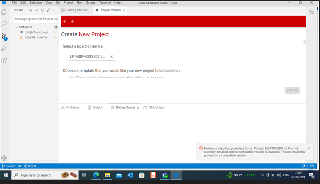

I have all ready installed the latest version of the SDK but still facing this issue.
Part Number: LP-MSPM0G3507
Could you try open the Project->import CCS projects. In select search-directory, choose the SDK installation path and find the demo examples you need to import into the CCS workspace.

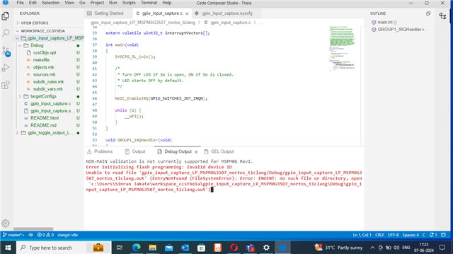

Thanks man,
that issue is resolved but facing the different issue could you help on this?

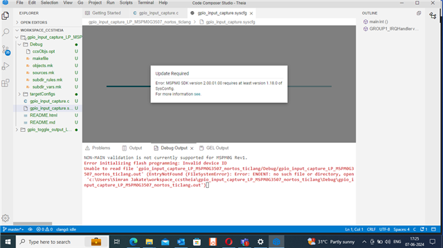

this one also
I have installed latest version of sdk as well as CCSTheia but still its showing you have download the latest version for sysconfig...
