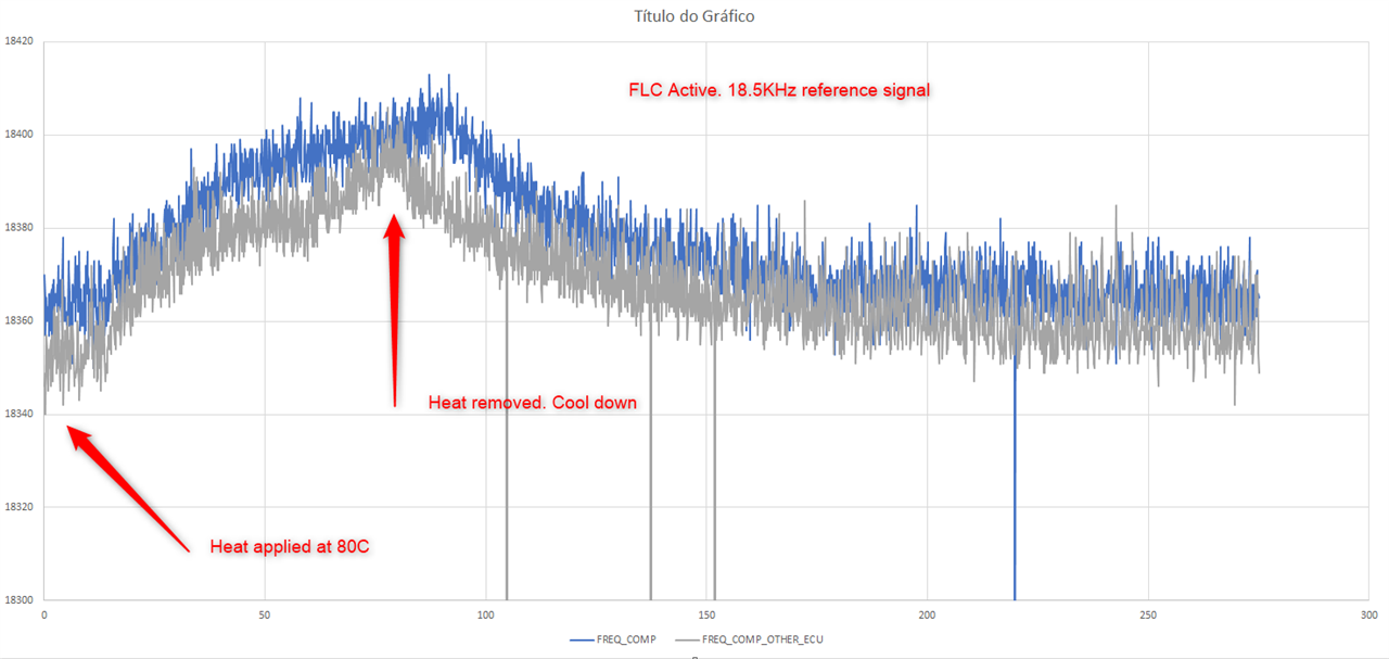

In my application, in order to improve the frequency measurement stability with temperature variations I enabled the Frequency Correction Loop functionality by calling this function right after the main code start.
DL_SYSCTL_enableSYSOSCFCL();
At hardware level,  the frequency correction loop (FCL) circuit utilizes an external 100-kΩ resistor, populated between the ROSC pin and VSS. I assembled it.
To verify the functionality, I exposed the MCU to a heat gun configured to 80'C and observed the behavior of the measurement of a fixed frequency input channel with FCL active and without.
What I observed was:
-FCL reduces significantly the measurement variation with the heating process comparatively to the scenario without its activation.
-FCL introduces a relevant offset at ambient temperature frequency measurement comparatively to the condition where it is not active (around140Hz)
I performed this test with two different systems, with the same result.
What is the maximum admissible tolerance for this resistor? Are these results in line with a core frequency of 32MHz and a 1% tolerance resistor?

  • Good morning,
    I had the opportunity to test your recomendations but unfortunately it did not resolve my problem.
    Following i will state the tests i did and what i found:
    Do the Peripheral init analog function and enable the SysOSCFCL().
    With a 100kohm 1% tolerance i get a difference of about 12Hz (0.7%) in my measured frequency 1600KHZ
    With a 100kohm 0.1% tolerance i get about the same value as above in my measured frequency 1600KHZ.
    With a 82Kohm resistor i get about the same value as initially. ( this test was just to check the impact of the ROS resistor in this mechanism)
    It seems that whatever resistor i put there, there is no improvement on the compensation mechanism.
    What i find strange is that if i just dont enable the FCL mechanism, my error at ambient temperature in this same measurement is around 1hz. However, the drift with temperature is higher as comparing with the scenario where i enable the FCL.
    What can i be doing wrong to not achieving a compensated frequency measurement at ambient temperature.

    We are not using sysconfig in our implementation. However if it clarifies better my setup i will simplify it as:
    1)Use a 1850Hz pwm signal with fixed frequency and 50% duty cycle connected to an input capture port.
    2)Get the counts value from the configured timer that measures the time between two consecutive interrupts (half period of the pwm signal.
    3)Given the configuration of the timer that supports the input capture peripheral, convert the timer counts into a time value or pwm signal full period frequency.
    4)Without FCL, at ambient temperature before applying heat disturbance,I measured it as 1852.0Hz
    5)With FCL active, at ambient temperature before applying heat disturbance, I measured 1836.0Hz.
    Once again, why is FCL introducing a higher error already at ambient temperature?
    Why even with a 80Kohm resistor (recomended 100Kohm 0.1%), i get the same behavior when I activate this compensation mechanism?
