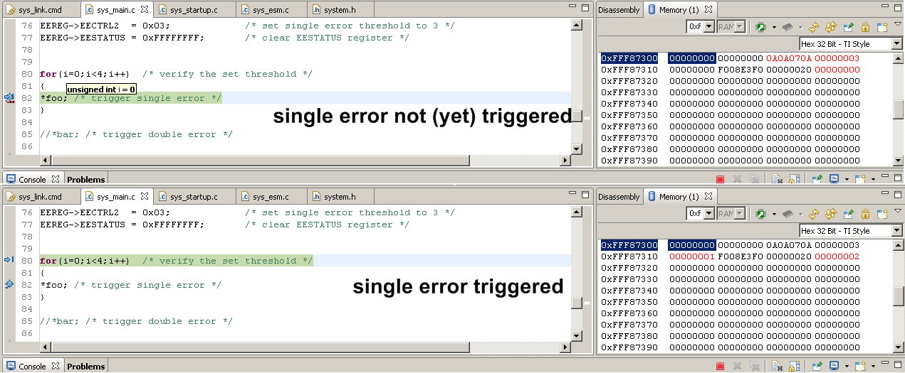

Hi there,
I wrote some Code where I access the pre-programmed single bit and double bit errors in OTP (see). I set the threshold for single bit errors to 3 in the EE_CRTRL2 register.
By pointing to the location of the single bit error the ErrorPinStat register in the ESM is dropping to low level. Therefore the error LED will be on. I expected this behavior after reaching the set threshold. Why is a correctable error causing the ErrPinStat register to be low when the threshold is not reached?
I attached my project files which were created with HALCoGen and compiled/debugged with Code Composer Studio 4.
Thanks in advance
Jonas
