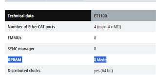

May I have question about Industorial-SDK for AM243x?
My customer using 3P stack and PRU-ICSSG EtherCAT driver (from ind-SDK).
Question 1
In SDK manual, it say there is 59kB of RAMs.
Is this same mean of RAM as ET1100's DPRAM?
https://software-dl.ti.com/processor-industrial-sw/esd/ind_comms_sdk/am243x/09_02_00_08/docs/api_guide_am243x/ETHERCAT_SUBDEVICE_FWHAL.html
https://www.beckhoff.com/ja-jp/products/i-o/ethercat-development-products/elxxxx-etxxxx-fbxxxx-hardware/et1100.html?
Question2
if Q1 is correct,
Can we use fully 59kB of RAM though ind-SDK's PRU-ICSSG EtherCAT driver?
Or is there anything to limit or constraints?
Question 3
How long is maximum packet of ethernet frame in my enviorment?
Or number of max frame is define EtherCAT stack (in R5F) side? PRU-ICSSG hardware and driver in ind-sdk have not constraints of frame size?

  • Hello GR,
    • Yes. 59kB RAM mentioned in SDK Manual corresponds to the DPRAM mentioned in ET1100 documentation.
    • You should be able to utilize the complete 59kB.
    • The max EtherCAT frame size is limited to 2000 bytes. Any frame bigger than that would be treated as an error frame.
