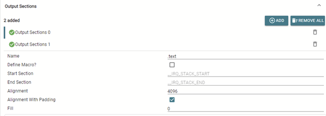

    • Go-to software>section>text-segments
    • Add new output section in Text Segments
      • Name it : .rodata.cfg
      • In .rodata.cfg "Enable alignment with padding"
    • Add new section in software→section
      • Name the section as desired: cio_grp1
      • Set the load memory as "OCRAM"
      •  Add output section in cio_grp1
        • Name: cio
        • Add input section in cio_grp1
        • Name: -llibsysbm.a<trgmsg.c.obj> (.text)
    • Go-to software→section
    • Open "Code and Read-Only Data" section.
    • Update "Load Memory" and "Run Memory" as FLASH
    • Keep the .text and .rodata section as flash 8 byte aligned
