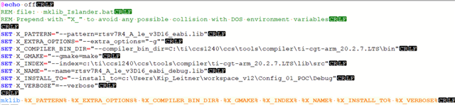

RM48L952: TI Tool "mklib" for custom Hercules Target Arm C/C++ and RTS does not work for CCS 12.6.0 and 20.2.7.LTS
Part Number: RM48L952
When I follow the instructions in the TI Compiler manual for ARM 20.2.7.LTS to build a custom library for Hercules RM48L952 chip, the process fails.
--> It seems the that the TI tool "mklib" cannot find the compiler tools, even though the directory is listed in the path.  The error message says that "armcl: not found", even though the tools seem to be in the correct directory and the directory is listed in $PATH environment variable:

The process we are supposed to follow used TI CCS VERSION 5, which is many years old.  There are mistakes in the Compiler manual.
The process is described in section 7.4 of TI document spnu151w.pdf
Here is the history of what I did, including error message at the end.  I am using Ubuntu 22.04 LTS installed as type 2 Windows System Linux ("WSL"), Windows 10.

cd /mnt/c/ti/ccs1240/ccs/tools/compiler/ti-cgt-arm_20.2.7.LTS/lib/src
/usr/bin/gmake -r -j 1 library CMD_FILE="/tmp/TI_MKLIBo2VAxr/_Makefile.cmd"
armcl dtor_list.c "g"  --fp_mode=strict --no_visible_enums --gen_func_subsections=on -mv7R4 --abi=eabi --float_support=vfpv3d16 -D_TI_USING_LIBCXX -me -c --ti_lib --keep_unneeded_types=false --diag_warning=225 --quiet -O4  --rtti -fg --building_runtime -DCHECKING=0 -I/mnt/c/ti/ccs1240/ccs/tools/compiler/ti-cgt-arm_20.2.7.LTS/lib/src -fe /tmp/TI_MKLIBo2VAxr/OBJ/dtor_list.c.obj -fs /tmp/TI_MKLIBo2VAxr/OBJ -ft /tmp/TI_MKLIBo2VAxr/OBJ -ppa -ppd=/tmp/TI_MKLIBo2VAxr/OBJ/dtor_list.c.pp
/usr/bin/sh: 1: armcl: not found
gmake: *** [Makefile:1931: /tmp/TI_MKLIBo2VAxr/OBJ/dtor_list.c.obj] Error 127
>> ERROR: mklib: gmake error during rtsv7R4_A_le_v3D16_eabi_debug.lib build
kleitner@xDER-kleitner-2:/mnt/c/ti/ccs1240/ccs/tools/compiler/ti-cgt-arm_20.2.7.LTS/lib$

  • Thanks George.  I am running many different tool chains and compilers from different vendors.  Let me take another look at my $PATH variable and all the installed software tools. I will report back tomorrow.
  • George, I fixed my problems.  Also, there are two serious errors in TI compiler manual spnu151W.pdf  (C/C++ ARM LTS Compiler) which misled me.
    I was working too fast and didn't realize that the build is supposed to run under tools compiled for my Windows 10 platform.  I originally thought the tools were supposed to run under a Linux emulation environment, so had setup a Linux emulation environment.  Once I converted everything to the TI-required toolchains cross-compiled for Windows, the TI "mklib" worked, but with a few problems.
    If you read section 7.4.1 of TI document spnu151w.pdf, you will see that I did this wrong because the manual is poorly written and has errors.
    To get everything working, I did the following:
    • Rewrote my command line call of TI "mklib" using Windows 10 syntax and environmental variables
    • Per TI requirement 7.4.1, installed gnuwin32 environment (gnu tools compiled for windows) and "make" version 3.81
    The problem in TI Document spnu151w.pdf,  -- at least for my version of the tools (20.2.7.LTS) -- is in table 7-2, "The mklib Program Options."
    The first option "index=filename" should instead read "index=directory", where directory is the top level directory for the TI library source code, in my case:
    c:\ti\ccs1240\ccs\tools\compiler\ti-cgt-arm_20.2.7.LTS\lib\src
    Also, it's not exactly clear in spnu151w.pdf, because it says NOWHERE IN THE INTRODUCTION that this compiler/assembler/linker/librarian toolchain is designed to work in both Windows and Unix environments.
    Thus, in section 7.4.1, the manual instructs the user to install both the "gmake and sh (bash)" utilities.  This is why I incorrectly thought this was an emulated Linux build -- because while gmake has been ported to run under Windows, there is no way to run a unix shell on Windows without installing a complete Unix/Linux subsystem.
    --> TI should fix section 7.4.1 of the manual and say
    • For Unix do (a), (b), (c) ...
    • For Windows, do (q), (r), (s) . . .
    There is no way to install the sh (bash) on a Windows machine without installing a complete Unix subsystem.
    Here's my final *.bat file for windows 10
    Once I setup the environment, PATH, env variables as directed, everything seemed to work OK and I got a build and a custom output library.  My "custom" build was actually just the default library built with the -g option added to the build process, but even though the -g option was on by default, running this script forced the compiler to rebuild everything.
    Here is the *.bat script I used:

  • I'm glad you found a way to make it work.  I should have sent you this forum thread link.  It shows how customers on Windows systems typically use mklib.
    Thanks and regards,
    -George
