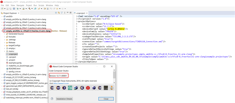

My project can be opened and configured just fine in CCS12.7.0.00007
...but cannot be configured in CCS12.7.1.00001 due unrecognized device:
I am using the latest SDK 9.2.0.56.
Creating a new workspace and re-importing the project does not fix the issue.
EDIT: The issue is not confined to my project. I can't even import an example project:
  • I am using the latest SDK 9.2.0.56.
    I can import the same project from the same SDK version in CCS 12.7.1.

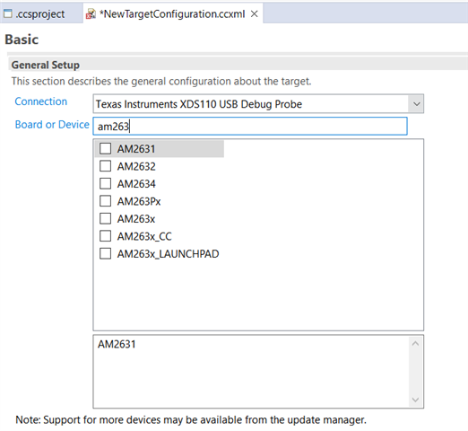

    It sounds like you don't have device support installed for AM263. Can you manually create a ccxml file for AM263*?
  • Ah, yes. Apologies. Looks like I clicked the wrong Sitara checkbox when I installed it.
