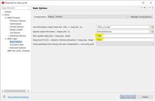

  • See below example where I set 1024 for heap and 2048 for stack. I don't know what your existing settings. Try to increase them and see if they make a difference and later fine tune the size.
    In the .cmd file you need to account for the new stack size so the Stack Pointer points to the right address.
