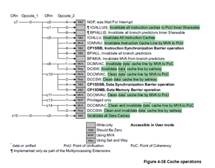

I discussed this with the person who created that FAQ. He mentioned that these functions are not generating by ( coreInvalidateDCByAddress() & coreCleanDCByAddress() ) by HALCoGen.
He told me that these operations can be found in the cortex-R5 TRM.
1067.DDI0460C_cortexr5_trm.pdf
In above TRM, please refer the section 4.3.22 (Cache operations).
Here they have given how to perform different cache operations:
As these entire operations are not generating by HALCoGen, we should need to create our API's based on requirements.
