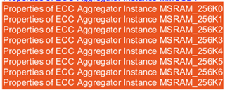

    2. Which ECC aggregator is utilized for Memory ECC diagnostic measures on-chip SRAM under normal conditions? And which aggregator would be used to inject errors if needed?
    You can use the below aggregators to inject error and enable ECC for SRAM.
