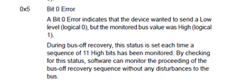

I am trying to use the CAN bus on my TM4C1294XL. I started with simple Rx and Tx codes and changed it to use CAN1 so I could use UART0 to monitor data. I am using two MCP2551 as transceivers with 120 ohm termination resistors with RS terminal grounded. When I try to transmit, I get an error on both controllers. I have one CAN transceiver connected to the stm board and the other to the tm4c129encpdt, the Rx interrupt occurs on the TM4C1294XL .
Status = CANIntStatus(CAN1_BASE, CAN_INT_STS_CAUSE);//Status = 0x00008000
Status = CANStatusGet(CAN1_BASE, CAN_STS_CONTROL); //Status = 0x00000065
How can I deal with the proplems and Why ?
my code are attached below, Could you help me to find the issue?

ui32Status = CANIntStatus(CAN1_BASE, CAN_INT_STS_CAUSE);
// If the cause is a controller status interrupt, then get the status
if(ui32Status == CAN_INT_INTID_STATUS)
// Read the controller status. This will return a field of status
// error bits that can indicate various errors. Error processing
// is not done in this example for simplicity. Refer to the
// API documentation for details about the error status bits.
// The act of reading this status will clear the interrupt.
ui32Status = CANStatusGet(CAN1_BASE, CAN_STS_CONTROL);
// Set a flag to indicate some errors may have occurred.
g_bErrFlag = 1;

  • I am trying to use the CAN bus on my TM4C1294XL. I started with simple Rx and Tx codes and changed it to use CAN1 so I could use UART0 to monitor data. I
    First of all, the example was developed for CAN0. If you want to use CAN0 then you just need to change the JP4 and JP5 on the board to the vertical position. Refer to the LaunchPad user's guide for details.
    Using the jumpers JP4 and JP5, Controller Area Network (CAN) digital receive and transmit signals can be optionally routed to the BoosterPack 2
    interface. The location of these signals is consistent with the CAN interface on the Tiva C Series TM4C123G LaunchPad and the Stellaris
    LM4F120 LaunchPad. In the default configuration, UART0 is used for the ICDI virtual UART and CAN is not present on the BoosterPack headers.
    In this configuration, the ROM serial bootloader can be used over the ICDI virtual UART. When the jumpers are configured for CAN on the
    BoosterPack, then UART2 must be used for the ICDI virtual UART.
    When you do so, you can still use the COM port through UART2 instead of UART0. Look at the InitConsole() function below and see how it configures UART2 for COM port.

    I will strongly you run the stock example first without any modification. First get it working and later you can modify per your application requirements. This will be much easier to diagnose your problem.
    Below is an example for can_rx that also has the UART2 for COM port.
    If you are getting a 0x65 it means there is a Bit 0 error. See below in the datasheet. I think you need to focus on the  bus more than the MCU. It is likely due to your transceiver. Again, look at the logic analyzer or even a scope capture that should reveal a lot of information. Looking at your code, I don't see a problem especially if you just copy the example.
