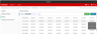

While using LP-MSPM0G3507, I am facing a problem about using internal temperature sensor.
1. First of all, below picture shows the TEMP_SENSE0.DATA  which read from uniflash.
The trimed value at 0x41C4003C = 0x2EEh = 750d.
USERID and DEVICEID also displayed in it.

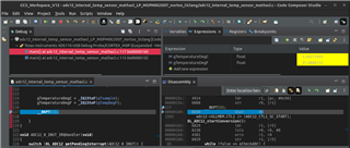

2. The example project from mspm0_sdk_2.1.0.03, "adc12_internal_temp_sensor_mathacl_LP_MSPM0G3507_nortos_ticlang"
The calculated value is 5 degree celsius, it is incorrect with my environment.
3.  There is an external thermistor on LP-MSPM0G3507 board which I can able to read from ADC and verified it with accurate value at 25 degree celsius.
The internal temperatue measured by ADC12 is approimate 0x323h/ 803d
Applying the formula described in TRM, the result is as same as the example does.
