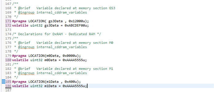

Hi all,
I looked on the example from TI regards ECC and Parity of RAM. I took it and adapted and it works for LS0-LS7, GS0-GS3 and M0 but for M1 is not working and I cannot figure out why.
This is how I declared the variables. The variables are declared at the right address. I looked in debug mode. Is the same function as for M0. It s just called with M1 variable and M1 section.
Any suggestions?
