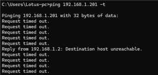

Its shows link up but not able to ping any of the port

  • Please  guide how to set NULL to SBL,
    New Observation: If only one LWIP instance used, same ip allocate to both the ports that ok
    if two LWIP instance used none of the IP allocated and not able to ping to both the ports
    Please lwip instance in above image
    Is Rx DMA Used By This Netif = 0 for both the instance?
    Rx DMA Used By This Netif = for both the instance?
    kindly check above setting also
    Within one LwIP instance, you can have multiple Network interfaces (NetIFs). These NetIFs will have an IP address. I would like to understand what is the reference to "LwIP instance"  here. Are you mentioning about the "NetIF" added through syscfg? Or are you initializing two LwIP instances in your code.
    This is correct, you would have to operate in MAC-only mode when Dual Netif system is enabled and Promiscuous mode enabled (if needed in your application).

    Sorry Vikas, My question is "What do you exactly refer to by 2 LwIP instances", are you creating two lwip instances in the examples manually or are you referring to the 2 NetIFs that you have added for 2 IP addresses. LwIP single instance also supports 2 IP addresses. The out of box example "enet-lwip-cpsw" has 2 NetIFs (2 IP Addresses) enabled by default and it has a single lwIP instance.
     MAC-only mode and Promiscuous mode ....
    There is not specific documentation for these.
    MAC-only mode: MAC-only mode which allows all incoming traffic from a given MAC port to be transferred only to the host port.
    Copy-all frames from MAC-only: When set a Mac Only port will transfer all received good frames to the host, When clear a Mac Only port will transfer packets to the host based on ALE destination address lookup operation (promiscuous mode)
