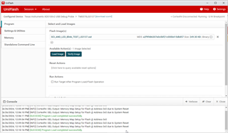

we have an issue regarding to jumping into a binary executable. We generate a binary executable for our target hardware using ccs when we upload this executable using uniflash, the code is not working properly. We were wondering what might be the problem. I would appreciate any support.

  • Hi Furkan,
    After loading did you do the power ON reset of the board?
    On my observation i found that, CCS doing power ON reset automatically after flashing the code, however if we load code through UNIFLASH then a manual power ON reset is required to execute the code.
    So please verify by pressing a PORRST button on the board.

  • Hi Jagadish,
    thanks for response.  When we run tiobj2bin command from the terminal it works without any problems. We are able to successfully upload and run the executable binary file on the target hardware. But when we generate the binary file from code composer studio the file is corrupted and it does not match the file generated from the commandline. We encounter this errror message using ccs to generate the binary file.
  • Hi Furkan,
    I don't know exactly how you are converting into the binary.
    I followed below method:
    1. I placed below tiobj2bin command in the post build steps:
    "${CCS_INSTALL_ROOT}/utils/tiobj2bin/tiobj2bin" "${BuildArtifactFileName}" "${BuildArtifactFileBaseName}.bin" "${CG_TOOL_ROOT}/bin/armofd" "${CG_TOOL_ROOT}/bin/armhex" "${CCS_INSTALL_ROOT}/utils/tiobj2bin/mkhex4bin"
    2. Now i did clean build my project
    3. After doing this i got the binary for my project in the debug folder:
    4. I load the binary into the flash using the UNIFLASH
    5. And i did reset and verified the output, my code is successfully running without any issues.
    6. Here is my code for your reference:
    8228.SCI_AND_LED_Blink_TEST_LS3137.zip
    Thanks & regards,
    Jagadish.
  • Hi jagadish,
    I tried your solution and it works. Thank you so much. I can successfully upload my executable.
