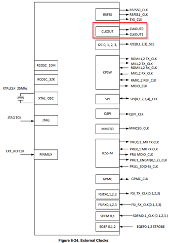

1. I want to test the Internal and External Oscillator on AM2634
2. How the clock is distributed between all the peripherals
  • Hello Swati,
    1) What is your expected methodology for testing these oscillator sources? Initial thought would be to use the CLKOUT[0:1] pins to route out the associated clock signal for verification.
    2) Please refer to the TRM Clocking (Chapter 6.4) section for details regarding the clock tree and IP distribution. Each IP has GCM (General Clock Manager) peripheral associated with it to select the available clock sources provided in the table in section 6.4.3.3 Clock Selection (Page 261).
    Hope this helps get you started and looking forward to answering any follow up questions that may arrise.
