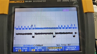

  • newTelegramMsg[0] = *(uint16 *)(fpga + 0x100);
    This is the oscilloscope waveform when this code is run.
    Black is the OE pin, blue is the Data pin.
    In any case, I ask whether garbage data should be read when OE goes from low to high.
    3. I don't understand which data pin, actually we should have 8 or 16 data lines right? but your waveform has only single data line? which data line it is?

    3. This is line D2. Because there weren't that many probes, I only took a picture of one data line.

  • Hi IBLEE,
    I think this is expected behavior only.
    Before explaining why, i want to clarify one more thing that is, how the data in the memory browser in the CCS is displaying for EMIF region.
    For below highlighted emif region, there won't be any physical memory inside the controller:
    If we trying to access this region, in the background EMIF communication will takes place to get the data in the corresponding region.
    So, in the similar way if you trying to access the 0x60000100 region from memory browser of CCS, in the background JTAG will send commands to the processor and in the background, it will read the data using EMIF.
    So now come to the why we are reading all 0's in DEV kit is, because in DEV Kit there is no EMIF slave connected for connected for CS2. I mean no asynchronous memory or FPGA was there in this region like what you have in your target board.
    So, if CCS trying to display this region as there is no slave memory connected to it right, so the data lines might give all zeros while EMIF communication takes place. That is the reason we are getting all zeros for this region in DEV KIT.
    However, in your target board you have FPGA for this region right. So, if CCS memory browser access this region in the background EMIF communication will takes place in the controller and we will get the data from FPGA.
    The data 0x40, 0x41 ... etc., all these data are from FPGA only. If you ask me why this data is received from FPGA, then i don't know why because it is depending on the logic used inside the FPGA. You should need to check the FPGA logic used inside the FPGA to understand why you are getting this data.

  • Dear Jagadish.
    I am currently connecting and using multiple PCBs on the target board, but a HW problem related to EMIF communication was discovered.
    Thank you for thinking about it with me and explaining it to me.
    First, I'll try again once the HW is fixed, and if I have any questions, I'll ask again.
    IBLEE
