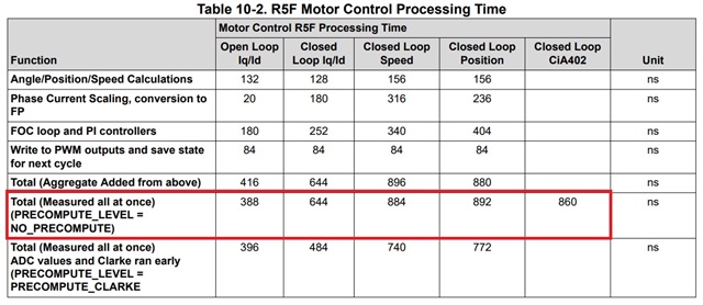

1.  Processing time
    Is the CPU processing time for control period the total of Open Loop Id/Iq, Closed Loop Id/Iq, Closed Loop Speed, Closed Loop Position and Closed Loop CiA402 ?
 2.  Difference between Table 10-2 and Table 14-5
    There are Table 10-2 and 14-5. Do the numbers in Table 10-2 come from the Max normalized in Table 14-5 ?
    If the customer wants to know the maximum value of CPU processing for control period, they should summate all of Max values in Table 14-5 ?
    It would be 4568 [ns] ?

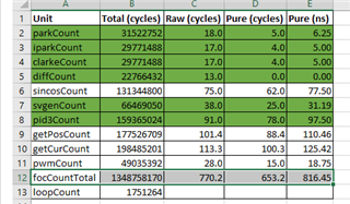

    There is new TI design  EtherCAT® Connected, Single-Chip, Dual-Servo Motor Drive Reference Design (ti.com) which uses the AM243x LP plus a BLDC Dual Motor launch pad which is available in ti.com and the source code is included in the Motor Control SDK since 09.00.00. I have a collected some average performance numbers for that setup (Closed speed loop only):
    focCountTotal is the total time for Closed Speed FOC loop.

  • Hi Ming, Mukul,
    Thank you for your response. The reason why we reffered to the older single chip single motor demo is that we need the benchmark data. The newer design app note doesn't it.
    Thank you for sharing the collected performance numbers.
        -  Could you tell us what Raw and Pure are ?
        -  Do you have Closed Position Closed Loop and Closed Loop CiA402 ?
        -  Actually, they want to know the processing time of EtherCAT CiA402 profile, Could you share it if you have ?
    We understood the app note which we referred to was older design, but could you please answer to their questions 1 to 3 described above ?

    1.  Processing time
    [MW] Yes. It is the total time from getting current/position feedback to the PWM output for each FOC type.
    [MW] No. See my answer above. Each time, you only use one FOC type.

    We have not implemented the Closed Position Loop in the new TI design, so we do not have performance numbers, but based on the performance numbers provided in the appnote. The numbers should be similar to the Closed Speed Loop, so is the Closed Loop CiA402. In fact, our new TI design, supports the CIA402 Speed Control.
