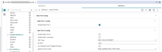

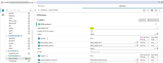

I am using mcu_plus_sdk_am263px_09_02_00_56 to with a custom PCB with 100BaseTx PHYs connected by RMII. In SysConfig I configure the MAC port as seem in the screen captures below:

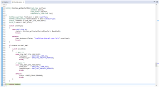

However, the SysConfig generated code in:
  \syscfg\ti_enet_soc.c
… seems to be expecting RGMII as seen here:
int32_t EnetSoc_getMacPortMii(Enet_Type enetType,
                              uint32_t instId,
                              Enet_MacPort macPort,
                              EnetMacPort_Interface *mii)
    EnetMac_LayerType *enetLayer = &mii->layerType;
    EnetMac_SublayerType *enetSublayer = &mii->sublayerType;
    uint32_t modeSel = CPSW_ENET_CTRL_MODE_RGMII;
    int32_t status = ENET_EFAIL;
    switch (enetType)
This causes
CpswMacPort_checkSocCfg() to return ENET_EINVALIDPARAMS
During EnetApp_enablePorts()
How can I fix this issue?
  • Hi Tollman,
    Apologies for a delayed response, I was out of office for a couple of days.
    Yes it is a valid bug. The modeSel is hardcoded for CPSW_ENET_CTRL_MODE_RGMII so it is expecting the RGMII configurations. I have filed a bug for the same. Meanwhile, I will try to get back with a workaround by tomorrow morning.

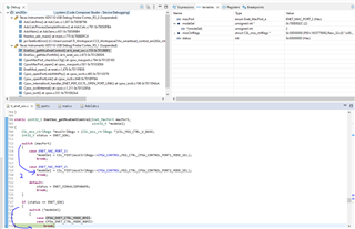

    It is not hardcoded. But we get the value from this function: "EnetSoc_getMcuEnetControl". Can you please halt the core and check the values, step into the function statements and check the behaviour? Since I don't have a RMII setup on my end, I am not able to directly do the same. Can you help me understand what value of modeSel do you get for the following:
    1. In EnetSoc_getMacPortMii function, what is the value of "macPort". This is passed as a parameter to the function.
    2. In EnetSoc_getMcuEnetControl function, does it correctly go to the case for MAC Port-2 and if it does, what is the value of modeSel after register read?
    Shaunak

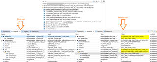

  • Hi Shaunak,
    I ran the tests you requested.
    This is the first execution:
    Then I ran it again, my intention was to compare what happens with my 'work-around' is removed. In hindsight, this has no affect on the code being analyzed here. However, this is what I saw:
    I noticed an unexpected difference. This prompted me to compare the variables windows side by side.
    I did not investigate further, but I have a suspicion that this difference may be related to MDIO read errors.
    Question:
    Are the values used for these comparisons read from the PHY with MDIO?
    Tollman

  • Hi Tollman,
    EnetSoc_getMcuEnetControl function reads from the MSS CPSW CONTROL reg, this is filled in EnetBoard_setupPorts function. In different runs, the values are expected to be the same.
    Can you please share what the "workaround" is?
