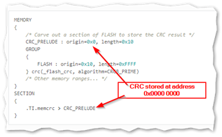

Reading between the lines, you want to calculate a CRC of your application at build time, store it somewhere, then have the application re-calculate the CRC at run-time and compare it with the build time CRC. Is that correct?
If so, you need to store the CRC outside of your application program at a fixed address. You can refer to the fixed address with a pointer or you can have a linker symbol associated with it. Then in your application CRC checker, you refer to the linker symbol as if it were a pointer.
Here's an example:
So your application CRC checker accesses the CRC by pointer to address 0x0.

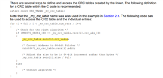

Please refer above application notes, here clearly explained how to generate the CRC using linker command file and they also given direct example code for TMS570LC4357.

And what you can do in the code is that you can extern this _my_crc_table structure, and you can use CRC module in controller to calculate the CRC in your code and then you can compare your calculated CRC with the linker generated CRC record in the _my_crc_table.
Here is the way of accessing the _my_crc_table CRC records in your code:
You can also verify the map file to understand the generated CRC by the linker:
