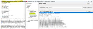

    In order to understand the enet_icssg_loopback_am243x-lp_r5fss0-0_nortos_ti-arm-clang environment, I tried importing it into a research folder.
    You can see the existence of loopback_***.c in the CCS Project Explorer. Green rectangle
    loopback_***.c cannot be seen in Windows Explorer.
    When I checked the loopback_cfg.c property in the CCS Project Explorer, I found that it was located in the SDK installation folder.
    I would like to refer to the source code in the SDK installation folder, such as the enet_icssg_loopback_am243x-lp_r5fss0-0_nortos_ti-arm-clang environment, but the R5F0-1 environment does not exist in the SDK installation folder.
    Cannot be referenced.
    In my build environment I don't reference the SDK Folder and I get build errors.
    I want to refer to the SDK Foler, like the enet_icssg_loopback_am243x-lp_r5fss0-0_nortos_ti-arm-clang environment.
    How can I reference the SDK Foler in R5F 0-1?

    In order to understand the enet_icssg_loopback_am243x-lp_r5fss0-0_nortos_ti-arm-clang environment, I tried importing it into a folder for investigation.
    In this sample, the SDK Folder is referenced from the Work Folder.
    If I change the CCS build settings, can I reference the SDK Folder?

    4. Now you can refer "mcu_plus_sdk_am243x_09_02_01_05\examples\networking\enet_loopback\enet_icssg_loopback\am243x-lp\r5fss0-0_nortos" project and change settings of your current project (in step 3)
    CCS project ==> Right_Click==> Property ==> Include_option
