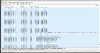

I am currently working with the TM4C1294NCPDT microcontroller's Ethernet peripheral for high-speed data transmission. While the continuous data transfer generally works, I am encountering an issue where the transmission suddenly gets stuck.
Here are the specifics of the situation:
  • Source Address: 192.168.1.1
  • Destination Address: Broadcast 192.168.1.255

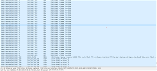

During the time when the data transmission gets stuck, I receive an mDNS response, after which data transmission ARp will sending.
How to increase the Stack Size in lwip ?
Then what we can do.....!

  • Hi Charles,
    We are encountering in our project, which involves data transmission using the LWIP stack with the UDP protocol.
    1. Source IP Address (Board): 192.168.1.1
    2. Destination IP Address (Board): 192.168.1.255 (Broadcast)
    3. Monitoring Laptop IP Address: 192.168.1.50
    We have configured our system to continuously transmit data from the board to the monitoring laptop or pc. The data transmission works correctly some time; however, we face intermittent issues when the laptop or pc provides mDNS (Multicast DNS) services to the board. During these instances, data transmission errors occur, causing interruptions.
    This problem is not consistent across all systems. While some systems continue to transmit data
    Thanks & Regards.
    Aravind.SR
  • I don't know the cause to your problem. I have a few questions.
    - If there is no MDNS then the board will continue to transmit? Is that correct? In another word, the board will only get stuck after a MDNS and you have not found other circumstances the board will get stuck.
    - When it gets stuck, and if you use the debugger to examine the processor, where is the code stuck at?
    - You said the problem is not consistent across all systems. Does that mean you have other boards running the same firmware will not get stuck when MDNS is sent out by the PC? Please confirm.
     - You seem to be sending 1240 bytes of datagram continuously using UDP. For experiment purpose, does it make a difference if you reduce to lower payload?
