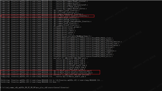

    Below is something about WDT currently.
    I have tried the command "gmake -s -f .\makefile.am64x.r5f.ti-arm-clang PROFILE=RELEASE" just now.but it did't work.Could you tell me the reason?
    sigong
  • I have tried the command "gmake -s -f .\makefile.am64x.r5f.ti-arm-clang PROFILE=RELEASE" just now.but it did't work.Could you tell me the reason?
    Actually, you are not using the CCS12.7.0 version.
    For executing make commands , Cygwin should be needed.
    Typically, this should come under the CCS version. So, users don't need to download separately.
    You do one thing, download the CCS 12.7.0 version and do the library compilation.

    Building target: "AC800_ethernetip_adapter_generic_device_mii_demo_am243x-lp_r5fss0-0_freertos_ti-arm-clang.out"
    Invoking: Arm Linker
    "C:/ti/ccs1270/ccs/tools/compiler/ti-cgt-armllvm_3.2.2.LTS/bin/tiarmclang.exe" -mcpu=cortex-r5 -mfloat-abi=hard -mfpu=vfpv3-d16 -mlittle-endian -mthumb -Os -DSOC_AM243X -DSOC_AM243X=1 -DOSAL_FREERTOS=1 -DEIP_TIME_SYNC=1 -DEIP_QUICK_CONNECT=0 -DCPU_LOAD_MONITOR=0 -DWDT_ENABLE=1 -g -Wall -Wno-gnu-variable-sized-type-not-at-end -Wno-unused-function -Wno-unused-but-set-variable -mllvm -align-all-functions=2 -Wl,-m"ethernetip_adapter_generic_device_mii_demo.Release.map" -Wl,-i"C:/ti/ind_comms_sdk_am243x_09_02_00_08/mcu_plus_sdk/source/kernel/freertos/lib" -Wl,-i"C:/ti/ind_comms_sdk_am243x_09_02_00_08/mcu_plus_sdk/source/drivers/lib" -Wl,-i"C:/ti/ind_comms_sdk_am243x_09_02_00_08/mcu_plus_sdk/source/board/lib" -Wl,-i"C:/ti/ind_comms_sdk_am243x_09_02_00_08/source/networking/icss_emac/lib" -Wl,-i"C:/ti/ind_comms_sdk_am243x_09_02_00_08/source/networking/icss_timesync/lib" -Wl,-i"C:/ti/ind_comms_sdk_am243x_09_02_00_08/source/industrial_comms/ethernetip_adapter/icss_fwhal/lib" -Wl,-i"C:/ti/ind_comms_sdk_am243x_09_02_00_08/source/industrial_comms/ethernetip_adapter/stack/lib" -Wl,-i"C:/ti/ind_comms_sdk_am243x_09_02_00_08/source/industrial_comms/ethernetip_adapter/stack/lwip/lib" -Wl,-i"C:/ti/ccs1270/ccs/tools/compiler/ti-cgt-armllvm_3.2.2.LTS/lib" -Wl,--reread_libs -Wl,--diag_suppress=10063 -Wl,--diag_wrap=off -Wl,--display_error_number -Wl,--warn_sections -Wl,--xml_link_info="AC800_ethernetip_adapter_generic_device_mii_demo_am243x-lp_r5fss0-0_freertos_ti-arm-clang_linkInfo.xml" -Wl,--ram_model -Wl,--use_memcpy=fast -Wl,--use_memset=fast -o "AC800_ethernetip_adapter_generic_device_mii_demo_am243x-lp_r5fss0-0_freertos_ti-arm-clang.out" "./CMN_CPU_main.o" "./CMN_app.o" "./CMN_board.o" "./CMN_mem.o" "./CMN_os.o" "./CUST_drivers.o" "./CUST_eeprom.o" "./CUST_ethPhy.o" "./CUST_flash.o" "./CUST_led.o" "./CUST_pruIcss.o" "./app.o" "./appCfg.o" "./appLed.o" "./appNV.o" "./appRst.o" "./appTask.o" "./appUart.o" "./appWebServer.o" "./app_device_profile.o" "./app_generic_device.o" "./app_generic_device_cfg.o" "./syscfg/ti_dpl_config.o" "./syscfg/ti_drivers_config.o" "./syscfg/ti_drivers_open_close.o" "./syscfg/ti_pinmux_config.o" "./syscfg/ti_power_clock_config.o" "./syscfg/ti_board_config.o" "./syscfg/ti_board_open_close.o" "./syscfg/ti_enet_config.o" "./syscfg/ti_enet_open_close.o" "./syscfg/ti_enet_soc.o" "./syscfg/ti_enet_lwipif.o" "./watchdog_interrupt_mode.o" "./customPhy/src/CUST_PHY_base.o" "./customPhy/src/CUST_PHY_dp83826e.o" "./uart_protocol/protocol.o" "./user_debug/user_debug.o" "./user_led/led.o" "./user_led/led_app.o" "./user_peripheral/user_peripheral.o" "./user_uart/uart_callback.o" "./user_uart/uart_echo_low_latency_interrupt.o" -Wl,-l"syscfg/linker.cmd"  -Wl,-lfreertos.am243x.r5f.ti-arm-clang.release.lib -Wl,-ldrivers.am243x.r5f.ti-arm-clang.release.lib -Wl,-lboard.am243x.r5f.ti-arm-clang.release.lib -Wl,-licss_emac.am243x.r5f.ti-arm-clang.release.lib -Wl,-licss_timesync.am243x.r5f.ti-arm-clang.release.lib -Wl,-lethernetip_adapter_mii_icss_fwhal.am243x.r5f.ti-arm-clang.release.lib -Wl,-lethernetip_adapter_lwip_contrib.am243x.r5f.ti-arm-clang.release.lib -Wl,-lethernetip_adapter_lwip_freertos.am243x.r5f.ti-arm-clang.release.lib -Wl,-lethernetipadapter_mii.am243x-lp.r5f.ti-arm-clang.release.lib -Wl,-llibc.a -Wl,-llibsysbm.a
    makefile:198: recipe for target 'AC800_ethernetip_adapter_generic_device_mii_demo_am243x-lp_r5fss0-0_freertos_ti-arm-clang.out' failed
    tiarmclang: warning: argument unused during compilation: '-mllvm -align-all-functions=2' [-Wunused-command-line-argument]
     undefined         first referenced
      symbol               in file
     SDL_UTILS_getDFAR C:/ti/ind_comms_sdk_am243x_09_02_00_08/mcu_plus_sdk/source/kernel/freertos/lib/freertos.am243x.r5f.ti-arm-clang.release.lib<HwiP_armv7r_handlers_freertos.obj>
    error #10234-D: unresolved symbols remain
    error #10010: errors encountered during linking; "AC800_ethernetip_adapter_generic_device_mii_demo_am243x-lp_r5fss0-0_freertos_ti-arm-clang.out" not built
    tiarmclang: error: tiarmlnk command failed with exit code 1 (use -v to see invocation)
    gmake[1]: *** [AC800_ethernetip_adapter_generic_device_mii_demo_am243x-lp_r5fss0-0_freertos_ti-arm-clang.out] Error 1
    gmake: *** [all] Error 2
    makefile:194: recipe for target 'all' failed
    **** Build Finished ****
    Are you trying to call SDL_UTILS_getDFAR API from your application ?
    Anil.
  • Yes.
    This is the location of the call.
  • Or another angle,is there a better way to find the reason why program comes into "HwiP_data_abort_handler_c"?
  • As an update, moving .end to the end of the asm.S file has solved the unreferenced symbol issue
  • Hello ,
    I have reproduced the issue on my side and this issue with not linking the .s file to the application.
    Please follow the steps below.
    1. I separately created.s and.h files under the folder below.
    2. Next, add the .s file to the make file as below.
    3. Compile drivers
    4. Compile Application
    .Exception_r5_utils.SException_r5_utils.h
    https://e2e.ti.com/cfs-file/__key/communityserver-discussions-components-files/908/makefile.am64x.r5f.ti_2D00_arm_2D00_clang
    Anil.
