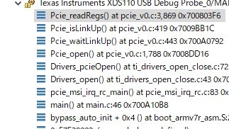

    They’re sure that there are some bugs in the PCIe driver like below.
    Could you please fix these bugs as soon as possible.
    • The driver doesn’t wait for PCIe link-up in the case of EP mode.
    • Region Windows Size of inbound cannot be changed on the SysConfig tool.
      => They are guessing that this is one of the root causes of the issue that data transfer cannot be operated.

  • Hello Hideaki,
    this is intentional, as an EP needs to perform additional configuration that is only possible once there is a reference clock. See the pcie_enumerate_ep for an example. If your customer wants to delay execution in the EP until a link is established they can call "Pcie_waitLinkUp()" before the call to "Pcie_cfgEP()":
        DebugP_log("Device in EP mode\r\n");
        status = Pcie_waitLinkUp(gPcieHandle[CONFIG_PCIE0]);
        DebugP_assert(SystemP_SUCCESS == status);
        /* Configure End Point */
        status = Pcie_cfgEP(gPcieHandle[CONFIG_PCIE0]
    I believe they're talking about the EP here. In that case it is intentional, as for an EP you need to configure the BAR aperture. Configuring the BAR aperture also configures the inbound ATU accordingly.
    Regarding the main topic of this thread:
    I've just checked the pcie_msi_irq examples. It does work as expected when either the RC or both the RC and EP are configured for Gen1. It does indeed not work when only the EP is configured for Gen2.
    The reason for this behavior is that the RC was modified as little as possible for SDK 09.02.01.05, preserving existing behavior. The existing code checked for the configured link parameters, so that behavior was preserved for the RC code. For the EP case, it is left to the application to a) wait for link up (see above) and b) verify link parameters.
    Before 09.02.01.05, the code would only check if a link was established with the configured parameters.
    Since 09.02.01.05, the code actually limits its own link to Gen1, for both RC and EP. For the EP, the checks were removed, for the RC, the checks were kept.
    If they want the RC to optionally support Gen1 or Gen2, and only limit then EP, they would have to remove the following lines from the pcie_v0.c and recompile the MCU+ SDK:

  • Hello Hideaki,
    Let me reconfirm, you did confirm below by using AM243x EVM or other boards ?
    I confirmed using one AM24x and one AM64x EVM.
    Not only link but also data communication work correctly ?
    Yes, communication working correctly.
    I noticed one issue with the pcie_msi_irq example in 09.02.01.05 in a different context: Depending on the startup order and timing variations you could see the following output:
    Endpoint Device ID: FFFFX
    Endpoint Vendor ID: 1X
    I had to re-try a couple of times until I got that issue. This should not happen if EP is started before RC. A proper fix is also possible:
             * retry reading vendor and device ID in case of CRS completion
            do {
                status = Pcie_getVendorId(gPcieHandle[CONFIG_PCIE0], PCIE_LOCATION_REMOTE, &vndId, &devId);
            } while (status == SystemP_SUCCESS && vndId == 0x0001 && devId == 0xffff);
    Could you explain below more detail ? 09.02.01.05 only supports Gen 1 ?
    Old behavior up to 09.02.00:
    SysConfig Gen 2: PCIe core can establish link at Gen 1 OR Gen 2, but software spins until link is Gen 2. If link can only be estbalished at Gen 1, e.g. because the remote end only supports Gen 1, the software spins forever.
    SysConfig Gen 1: PCIe core can establish link at Gen 1 OR Gen 2, but software spins until link is Gen 1. If link is established at Gen 2, the software spins forver.
    Old behavior is the same for RC and EP.
    New behavior starting with 09.02.01:
    SysConfig Gen 2: PCIe core can establish link at Gen 1 OR Gen 2. The EP driver doesn't verify which Gen was established, and leaves that to the application. The RC driver still verifies that a link was established at Gen 2.
    SysConfig Gen 1: PCIe core can establish link ONLY at Gen 1. The EP driver doesn't verify which Gen was established, and leaves that to the application. The RC driver still verifies that a link was established at Gen 1 (which should be true).
    New behavior is different for RC and EP.
    The next release MCU+ SDK 10.1 also will be same as above ?
    If so, they have to remove some lines and recompile the MCU+ SDK ?
    I can't comment on upcoming MCU+ SDK releases. I believe it makes sense to modify the RC driver to NOT verify which Gen a link is, and leave that to the application.
    Until such a change is available in a MCU+ SDK release, they could remove some lines and recompile the MCU+ SDK to get the desired behavior.
    Dominic

    • Version :         MCU+ SDK AM243x Ver.9.01.00.41
    • Library :          Drivers.am243x.r5f.ti-arm-clang.debug.lib (No modification)
    [ Modification ]
         1. Set the structure “Pcie_DevParams” .linkSpeed as the structure “Pcie_Attrs” .gen
         2. Call Pcie_open()     (In the example code, Drivers_open() is called.)
    < Details >
    Added the following five lines.
    extern Pcie_InitCfg Pcie_initCfg;
    extern Pcie_Attrs gPcieAttrs[];
    void func(void)
        Pcie_DevParams  *p_Pcie_DevParams;
        p_Pcie_DevParams = Pcie_initCfg.dev.basesPtr[0]->devParams;
        p_Pcie_DevParams->linkSpeed = gPcieAttrs[0].gen;
        Drivers_open();
    [ Results ]
    They confirmed that the transfer time of Gen 1 became twice of that of Gen2.
    • How to confirm
                  In the Block transfer
                    Set GPIO to High when the first data of block is received at receiver.
                    Set GPIO to Low when the last data is received.
                    Measure the time between High and Low.
    • Confirmed Register
                  Address : 0x0F10_0014
    -  Bit [5:4] = 01 (at Gen 2 setting),  00 (at Gen 1 setting)
    Reference :
        PCIE0_LINKSTATUS Register (Offset = 14h)
            bit[5:4] :  NEGOTIATED_SPEED
                    11:  16  GT/s
                    10:   8   GT/s
                    01:   5   GT/s
                    00:  2.5 GT/s
    [ Details of Operation in Driver ]
     The structure “Pcie_DevParams” is declared with the initial value in the pcie_soc.c.
    “Pcie_DevParam” .linkSpeed is fixed as PCIE_GEN2. ---- 1)
    The structure “Pcie_Attrs” defined in the pcie.h is declared with the initial value in the ti_drivers_config.c.
    This initial value is set by SysConfig tool.
    • If Gen 1 is set by SysConfig,
               “Pcie_Attrs” .gen = PCIE_GEN1  ---- 2)
    When Gen 1 is set by SysConfig, the setting of 1) and 2) doesn’t match, False.
    This is the root cause why program counter cannot exit from Pcie_open() and Gen 1 didn’t work.
    If their modification mentioned above is applied, 1) can match with 2), the program can exit and Gen 1 can work.
    Please check if their modification is correct.
    Thanks and regards,
    Hideaki
  • Hello Hideaki,
    yes, that modification is what limits the PCIe speed to Gen 1. A device configured that way will only establish a Gen 1 connection, and then the 2) check succeeds.
    If they want to ensure their device only works at Gen 1, then yes, this modification is correct.
    Dominic
