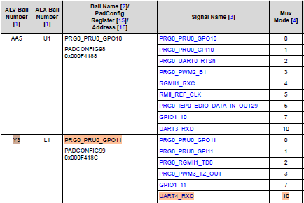

My customer has a question about PinMuxConfigSummary.
Does the Selected Mode Number in the PinMuxConfigSummary sheet indicate MUXMODE ?
If so, is it no problem even if MUXMODE value are not aligned for each interface ?
For example, the MUXMODE value of each pin of UART may be different in the same channel.
If it’s a problem, can the MUXMODE value be set arbitrarily by software settings etc. ?
PinmuxConfigSummary.csv
