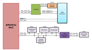

AM2634: Not able get I2C output on SCL and SDA lines for I2C2
Part Number: AM2634

 I have interfaced I2C based digipot to I2C2. I am using code from resource explorer "i2c_read_am263x-cc_r5fss0-0_nortos_ti-arm-clang". However, not able to see any output on scope for both the pins.
SDA pin : C6
SCL pin:  A5
I2C2 configuration is given below

  • Hi Ajith,
    Looks like you're configured to a wrong pin.
    The correct pins are mentioned in the user guide https://www.ti.com/lit/ug/spruj09d/spruj09d.pdf?ts=1723183030506.
    Can you try changing to this in the sysconfig?
    Let me know if the issue still exists
    Abishek S S
  • Hi Abhishek,
    As per the datasheet, I2C2 is only coming out on HSEC pins as shown below not on B7 and C7 as shown in page no 43,.
  • Hi Achishek, also please let me know pins for I2C0 and I2C1
  • Hi Ajit,
    The pin names you have shared are the pinmux options. If you select B7 or C7 in the sysconfig, our SDK pinmux driver will configure the mux to route the signal to I2C. I hope this answers your question.
    Also for I2C1, please use the pins suggested from Sysconfg
    Abishek S S
  • Sure Abhishek, I have selected C7 and B7 from syscfg options for I2C2 as shown below
    For I2C0  SCL->A13  and SDA->B13
    For I2C1 SCL->D7 and SDA ->C8
    Please verify.
    And also I am using external pull ups of 4.7k and freq of 100KHZ
    We are connecting AM2634 control card to
    TMDSHSECDOCK  to use all I2C pins. I will use HSEC pinouts of getting Dock station pins
    Thanks!
  • I2C3 SDA ->A16 SCL->B15
  • Still not able to get I2C waveforms from I2C0 pins SCL->A13 and SDA->B13
    Trying to send 0x55 on I2C0 but not seeing any waveform on scope.
    Appreciate your urgent support!

  • Ajit,
    Are you setting the select bit of the I2C0 MUX correctly?
    This signal, which comes from the I2C-controlled IO expander must be set HIGH to route signals to the HSEC pins of the control card EVM.
    Brennan
  • Hi Brennan,
    I have configured I2C pins for I2C0 in syscfg. Do I need to do anything else for I2C0_MUX_SEL bit.? how can I do it in code? how can verify if its already done in code?
  • Hi Brennan,
    I also started checking for I2C1 since I2C1 pins are directly connected to HSEC180 connector.
    But still not getting any waveforms on I2C1SDA and I2C1SCL pins.
    Please support on this!
  • Ajit,
    For I2C0_MUX_SEL bit, you need to send an I2C command to the IO expander device on the AM263x-CC to set the bit high. You can find example IO expander code at the SDK example at file location mcu_plus_sdk_am263x_09_02_00_56\examples\drivers\gpmc\gpmc_psram_io\am263x-cc\io_expander.c
    For I2C1, can you please describe how you are probing the SDA and SCL pins and what connections you are making?
    Brennan
  • Hi Brennan,
    I will check io_expander code for I2C0
    For I2C1, I am using below connections
  • Ajit,
    Are you connecting each scope probe to a common GND point on the control card?
    Brennan
  • Ajit,
    Have you tried probing any of the other I2C peripherals on the HSEC pins?
  • Hi Brennan, Yes I have tried I2C2 but same result.
    Is it possbile to discuss this issue over call? If yes then please let me know suitable timings and timezone. I will schedule meeting.
  • I2C1 is directly coming on HSEC connector as shown below. Then why am I not getting I2C signals on pin 85 and 87 of HSEC Docking station.
    Please find below are syscfg and code files

    This is very urgent for project milestones and delivery. Please review and support on this. Is there any example where I2C1 is used?
  • Hello Ajit,
    Brennan is on leave currently so I will step in here to try and help.
    I don't have the full hardware setup to test the I2C1 connection today but will have that available on Monday. In the meantime I can do a review of the schematic / SysConfig / code to identify any issues with it.
    RE: examples with I2C1 I'll review the SDK examples but we don't usually have examples for every serial communication port.
    Ralph Jacobi
  • Hello Ajit,
    Reviewing the SW + SysConfig everything seems to check out on the surface. I verified your pin selections are correct based on the ControlCard schematics. FYI we have pull-ups on the ControlCard so you don't even need those on the I2C lines. I don't think they are doing any harm but you can simplify your test setup.
    So you are probing directly at the ControlCard HSEC pins without using the Dock? I've never tried probing signals like that before but it's doable in theory. Can you send an image of the exact HW setup so I can verify vs our schematic that you are probing the correct pins then?
    Ideally it would be better to use the HSEC Dock here. If so, let me know which pins you are probing on that. While I don't recall running into this with I2C, I've had a past instance where documentation misled on which HSEC Dock pin to probe so would want to verify exactly where you are probing.
    I will have a full HW setup on Monday where I can run your exact code and validate on my end. Also checking with another team member if they can do similar today.
    Ralph Jacobi
  • Sure Ralph, Appreciate your support!
  • Hi Ralph, I am using dock for testing signals for I2C1. I am connecting to 85 and 87 on dock
    HW setup picture as given below.
    Is there any issue with SW?
  • Currently I am using i2c_read_am263x-cc_r5fss0-0_freertos_ti-arm-clang from resource explorer and trying to configure I2C1 in this. I have already shared SysCfg and code details.
  • Hi Ajit,
    Are you powering the dock from the USB-C connector on the Dock when running the test? Or if not how are you powering the setup?
    Ralph Jacobi
  • Hi Ralph,
    I am using Type-C adaptor to power up the control card. Dock card is getting supply from control card. I have also tried using SPI pins on dock station and SPI works but I2C1 is not working
  • Thanks Ajit, one of my team members is working to replicate this exact setup. Will report back when they have results.
    Ralph Jacobi
  • Hello Ajit,
    My team member confirmed operation of I2C1 on the AM263 ControlCard + HSECDOCK setup with Pins 85 and 87 outputting I2C using a project built from the SysConfig / Application code you provided with one edit being hardcoding the I2C address instead of using the Board_i2cGetEepromDeviceAddr API which was just to streamline the test.
    Given this result, I would expect you get proper outputs on your board. Is the image shown without the debug connections made? Because Pins 85/87 aren't being probed on that image.
    Ralph Jacobi
  • Yes, in the image it's not connected. But I am connecting it to 85 and 87 to scope.
    Is it possible share syscfg and code files so that I can compare and check the issues.
  • Hello Ajit,

    Okay so as far as I2C0 goes - that is actually routed to the Board ID EEPROM usually. From what I can see you could also route it with the HSEC mux option and then use it as an I2C on the HSEC pins but you'd have to add the pull ups at that point.
    If so, we'd need to set the I2C0_MUX_SEL output from the I/O expender to be high.
    Would that be suitable for your needs? If so I'll provide a project that handles all of those elements tomorrow.

    That said here is the IO expander scope to handle the I2C0 mux. You'll need to configure I2C2 for pins C7 and B7 at 400kHz and then run this:
