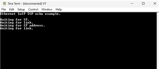

Hi Everyone,
I am performing enet_tcpecho_server_lwip example on EV board but unable to get IP address on terminal window. As seen below:
I am getting below output:

Please help me to resolve this issue.

      Does your network have a DHCP server? This example relies on the DHCP sever on your network to provide a IP address to your board.
      I assume you have a good Ethernet cable (e.g. CAT5E) connected between the board and the network, correct? Can you try a different cable?
      Do you have another board? Do you see the same problem on another board?
      Have you tried a different network? For example, try your home network with a router and see if it makes a difference if you are having a problem running on a company network. This way you can isolate the problem if it is network related.
    I am using static ip address.
    Below is the test setup:
    Terminal Output:
    Wireshark Output:
    Query: How can i see board ip address(which is showing in terminal window) in wireshark window?
    Gaurav
  • I am using static ip address.
    I'm really confused. On your posted code, you are initializing lwIP with DHCP, not static. See below your posted code.
    Wjy don't you refer to the enet_tcpecho_server_static_ip_lwip example in this app note. Go to section 6 for static IP configuration.
