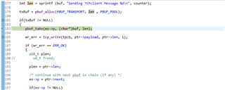

Hi team,
I am working on TCP client implementation on evaluation Board  so, i am editing this enet_cpsw_rawhttpserver_am263x-cc_r5fss0-0_nortos_ti-arm-clang Project.
 * tcp_client

static void tcp_client_send(struct tcp_pcb *tpcb, struct tcp_client_struct *es)
//    struct tcp_client_struct *es = 0;
    struct tcp_pcb pcbTx;
//    struct tcp_pcb *tpcb = 0;
    struct pbuf *ptr = 0;
    err_t wr_err = ERR_OK;
    struct pbuf *txBuf;
//    tcp_pcb *pcbTx;
    char buf[1000];
    /* get pointer on pbuf from es structure */
    ptr = es->p;
    int len = sprintf (buf, "Sending TCPclient Message %d\n", counter);
    txBuf = pbuf_alloc(PBUF_TRANSPORT, len , PBUF_POOL);
    if(txBuf != NULL)
       pbuf_take(es->p, (char*)buf, len);
       wr_err = tcp_write(tpcb, ptr->payload, ptr->len, 1);
       if (wr_err == ERR_OK)
         u16_t plen;
//         u8_t freed;
         plen = ptr->len;
         /* continue with next pbuf in chain (if any) */
         es->p = ptr->next;
         if(es->p != NULL)
           /* increment reference count for es->p */
           pbuf_ref(es->p);
         else
           /* other problem ?? */

I am using this code so if you see i am facing some issue My debugger is reaching up to till here pbuf_take() function
after my debugger is not going to next line
but i checked inside the function also i could't able to resolve ,so can you say any suggestion regarding this.
if my logic is wrong can you provide some example project regarding this.
Thank you,
  • Hi Aakash,
    Seems like you are running out of pbuf memory and pbuf_take is failing.
    pbuf_take() will return an error, but in your implementation I don't see the function return value being stored in any variable. Probably the error here is ERR_MEM (which means no pbufs left). Are you handling the pbuf_free() properly? Incase you are sending out large amounts of data and need more Pbufs, please try increasing the pbufs in lwipopts.h file and rebuild the lwip stack.
    You can also halt the core and check the "lwip_stats". They will show the pbuf memory related errors as well.
    Shaunak
