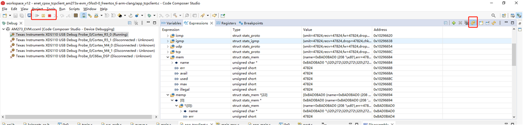

  • Hi Shaunak,
    1. I uploaded the lwipopts.h file.This configuration works normally in the mmwave_mcuplus_sdk_04_02_00_03 version SDK.
    lwippools.h

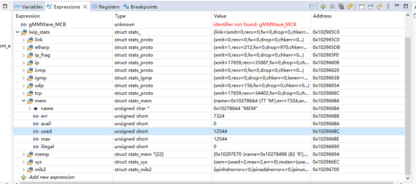

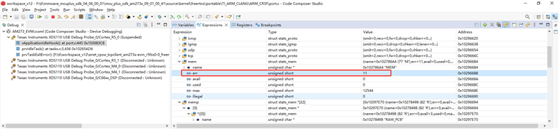

    2.The first time I set the data length to be transmitted to 800K, and then send a packet every 450ms, TCP can establish a connection normally,but no data output. When the program is running, CCS debug, select "Continues Refresh" mem information as shown below
    When I halt the core ,mem information is as follows:
    I run it several times and the error message value was changing。

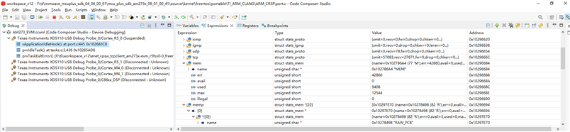

    3.A packet of 8K data is selected to send, and the delay after sending 100 packets is 450ms。
    After sending 258M data, the network became abnormal. I halted the core. The screenshot is as follows:

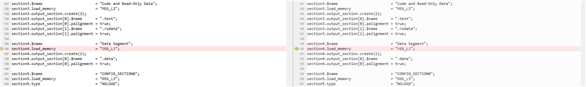

    4. I uploaded the modified file. The changes are very small. You can download it directly to reproduce the problem.

    There are two modifications in the syscfg file, as shown below:
    The left side is the modified code, and the right side is the original code
    Thank you very much, looking forward to your reply
  • This test sends 4K data per packet, sends 20 packets continuously, then delays 450ms and halts the core. The screenshots are as follows:
    Screenshot shows LwIP memory is exhausted。Sending different amounts of data causes different phenomena. When sending 800K at a time, LwIP memory is not exhausted (the second screenshot above), but there is no data output at all. There may be different bugs.

    • The issue here is very clear, we are running out of memory. Now the LwIP-stack takes care of freeing up the netbufs (network buffers which hold the packets). Seems like when trying to send out a lot of data, the network buffers are not being freed at a rate faster than which they are used, so at a certain point, we run out of netbufs and thus the program crashes. Now, we cannot increase the LwIP Memory pools to a very high number since the memory we have is limited. We can also try to increase the TCP segment or window size so we handle more data.
    Q. Can you pleas check if the application work if you do not change the memory locations as shared above in syscfg?
    Q. In the following file (which configures the LwIP stack, mcu_plus_sdk/source/networking/lwip/lwip-config/am273x/lwipopts.h , please try increasing the Netconn TCP macros "MEMP_NUM_NETBUF", "MEMP_NUM_TCPIP_MSG_API", "TCP_SND_BUF"
    Increase the MACROS keeping in mind the following calculations:
    • TCP_SND_BUF < (2 * TCP_MSS)
    • TCP_SND_QUEUELEN < (2 * (TCP_SND_BUF / TCP_MSS))
    • TCP_SNDQUEUELOWAT >= TCP_SND_QUEUELEN
