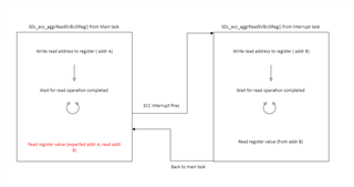

    I work with Manmath and Luis and investigated this issue.
    To summarize quickly,
     - We are operating from the M4F core
     - We are injecting single bit errors only
     - Code is running from the M4F SRAM only. Running from DDR is not an option due to the architecture and functional safety requirements.
    After investigation, I came to the conclusion that it is the fact that the aggrBus read and write functions are used both from the main branch and from ISR, combined with the bus reading interface which causes trouble in certain cases.
    Below is a diagram of my guess:
    Disabling interrupt before read/write operations and re-enabling it after solved the problem.

  • Hello Fabien,
    To be able to quickly reproduce the problem, we had to make a while() loop which injects errors at the highest possible rate into the memory.
    The memory address is not fixed but iterates from 0x30000 to memory end and then loop back to 0x30000.
    Can you share what you are doing here? I will try inject errors similarly to see if I can reproduce the issue.
    Also, when you don't have this while loop where you inject errors continuously, do you see the issue of getting stuck inside the SDL_ecc_aggrReadSVBUSReg function?
    Nihar Potturu.
  • Hello Nihar. Without the while loop this condition doesn't happen. But we need the loop as this is part of our continuous test (CBIT). We will share the scenario with TUV and let you know if they need more information. Thanks
