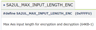

Is it possible to encrypt and decrypt more than 64KB using AES CBC?
The AM64x MCU+ SDK (Ver09.01.00) states that the maximum length is 64KB-1,
but I would like to encrypt and decrypt an application (1-2MB) using AES CBC. Is there any way to do this?
Or would it be better to encrypt and decrypt using a different method instead of using CBC?

  • Hi Yukinobu,
    This is the maximum packet length. In case you want to encrypt/decrypt more data, it must be processed in chunks of maximum lengths like it is already done in the SA2UL driver.
    So, you may encrypt/decrypt 1-2MB data by increasing the buffers length accordingly.
