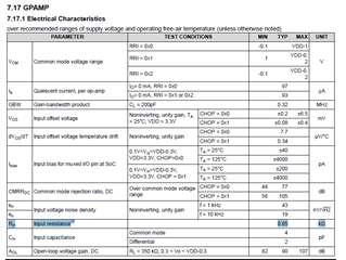

Does anyone what the GPAMP non-inverting terminal input impedance is?

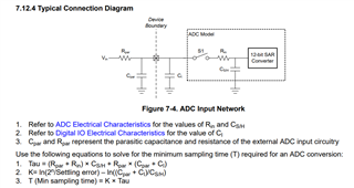

I would like to use the internal GPAMP as a RRI high-Z unity gain buffer, with the output going to the ADC (which has a 500 Ohm input impedance.

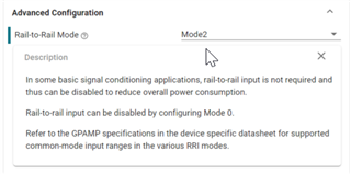

Also, how should the SYSCFG be set up? I do not see a way to set the RRI register to 2 for full rail-rail input.
