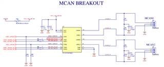

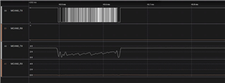

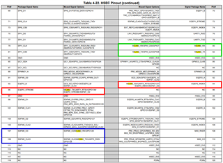

Hi Team,
MCAN0 is directly coming on HSEC connector (CAN_Tx - Pin no.82 and CAN_Rx - Pin no - 80). Then why I am not getting CAN Tx signal on pin 82 of HSEC Docking station.
Please find below are syscfg tool configuration and interrupt method code file.
