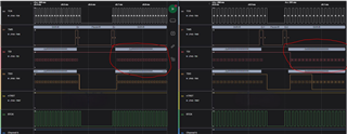

I am currently working on a custom board featuring the TMS570LC4357 microcontroller and have encountered an issue when attempting to connect it to Code Composer Studio (CCS). Specifically, I receive a "cable break" error.
I have verified that my custom board uses the same FTDI chip as the evaluation board. However, despite this similarity, my board fails to connect properly. I have analyzed the signal data from both the evaluation board and my custom board using Saleae Logic 2 software. The results indicate a failure during the connection process on my custom board.
Could there be any specific checks or configurations in CCS that might not be compatible with my custom board? I have attached the signal readings for your reference.
Left - Custom Board; Right - Evaluation Board
I appreciate any guidance or insights you can provide.

  • Hello Jagadish,
    I am working with Miguel catana on this issue.
    I just want to clarify some details to help describe the issue.
    On the image provided on the left side is the JTAG signals on our custom board. On the right side is the signals measured on the TMDX570LC43HDK  development kit.
    The hardware schematic is very similar to the schematic of the develpment kit (same pull-ups and connections). The main difference is that we do not have the CPLD between the FTDI and the MCU.
    The error occuring is on the "Test Connection" procedure. From the sequence of the test described in the code composer studio windown it seems to be failing with the test to write 0x00000000 (64 block of 32 bit). This i where the indication o the "cable break" error occurs.

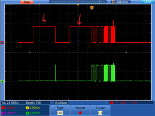

  • Hello Jagadish,
    Thank you for the information on the XDS100.
    We did some test on our side and found the following.
    Measuring the signal on the FT2232HL and the MCU side on the  TMDX570LC43HDK development board we see a slightly different behavior of the TDO line (see image bellow, red JTAG_TDO on FT2232HL side, green JTAG_TDO on MCU side).
    We assume it has something to do with the Adaptive clocking feature of the FT2232HL that could drive the TDO signal. is this correct? We also see this on our custom board.
    Could this be causing issue with the "Test connection" procedure?
    Is it possible to disable this adaptive clocking from the code composer studio? or does it require some different method?
    Is the CPLD an absolute requirement for the XDS100 debug/programmer? or it would also work without the CPLD?
    Is there any detailed description of the "Test Connection" procedure?
    If it helps understanding of the capture we have logic analyzer captures that we did on both the custom and TMDX570LC43HDK (Using Saleae Logic software) that we can provide you. What would be the best option for us to provide you with the files?
    Luis Aguiar

  • Hi Luis,
    The CPLD is required for xds100V2.
  • Hello QJ,
    Thank you for the information.
    So we can assume the reason it fails the Test connection is due to the CPLD is not being used on our custom board. Is this correct?
    We are waiting to arrive a XDS200 debug emulator and we will attempt to externally program the MCU over a JTAG connector.
    I will keep you informed if we still experience any issues.
    Most likely the problem is related to the CPLD.
    If you like to add an emulator on your PCB board, xds110 is a better option which is used on tms570lc43x launchpad.

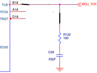

    The TCK, TMS and nTRST signals must be connected in parallel to all devices connected to the daisy-chain. nTRST signal should be pulled down to GND via a resistor (for example 10kohms). It's nice to have a low pass filter (R-C filter) on nTRST at JTAG header to prevent the noise.
    The TCK signal is particularly sensitive to reflections. It should be kept very short with no stubs when routing from JTAG connector then to first device then to 2nd/3rd device. Using an AC termination at the last device is a good idea. The AC termination is a small resistor and a capacitor in series to GND.
    The TDI and TMS should be pulled high (3.3V) with 10Kohms resistors. Each device's TDO should be pulled down to GND with a 10kohm resistor. It's better to have a series resistor (for example 22ohms or 33ohms) on the TDO of the last device in the daisy-chain.
    It is important that you avoid cross talk on all JTAG signals. This is usually an issue in the cabling, not so much in board layout.
