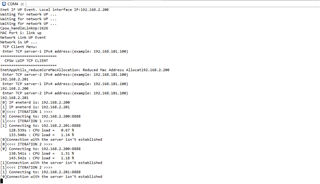

Hi team,
i am working on enet_cpsw_tcpclient_am263x-cc this project and in this project i am trying to configure 2 Ip's so here i could able to ping 192.168.2.200 but i could not able to ping 192.168.2.201
i am using the app.main which i attached below

i am using this app_tcpclient.c file to netconn_connect other things and i attached below

Here if you see in this picture i could't able to ping the the ip
i saw some comments from you and i am working on the same
so can you say wat is the problem in mine. or can say any thing require i need to change??
your replay is very much helpful.
  • Hi Aakash V,
    The above codes and screenshots have been shared by me in the following thread: https://e2e.ti.com/support/microcontrollers/arm-based-microcontrollers-group/arm-based-microcontrollers/f/arm-based-microcontrollers-forum/1369062/am2634-send-data-to-two-servers
    In the last screenshot attached I see that the connection with the server is established (both the servers). The ping not working is because the socket connection is probably in a listen mode waiting for data, the lwip stack is receiving your Ping Request but not responding back.
    The issues seems with the priority of the FreeRTOS tasks, since both the tasks have same priority the data is getting jumbled. For every different socket, you will have to spawn a new FreeRTOS task and handle the connection in parallel. This is a situation of a race condition, the data comes at the same time and FreeRTOS keeps switching between the two tasks so the data gets jumbled. Since the above code is not a part of SDK and already provided as an Add-on in the above linked E2E, you can try playing around with FreeRTOS priorities and task handling to get the required functionality.
    Shaunak
