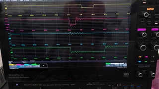

  • I tried to read and write all the CS in the EPI bus for which I initially checked for the ALE,RD,WR,CS enables in Oscilloscope.
    For chip selects 2 and 3( 0xA0000000,0xC0000000) is fine as expected, ALE is getting high and constantly low. (yellow signal is rd enable and pink is ALE)
    But for chip selects 0 and 1( 0x60000000,0x80000000), ALE is inverted(getting low when required and constantly high) (yellow signal is rd enable and pink is ALE)
    can you please help me get the right behavior

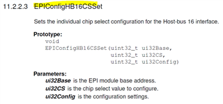

  • I don't see you configure each CS using EPIConfigHB16CSSet.
  • Thanks Charles, it worked

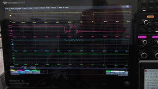

  • Hello Charles
    This is similar to the previous issue where CS2 and CS3 are fine and other two chip selects having the issue of getting stuck in while(1) of default handler while accessing addresses more than 128.
    I also tried the same code with a launchpad which has no external devices connected, same is happening.
    Is there something i'm missing in the configuration?

                                                   EPI_HB16_ALE_HIGH
            EPIConfigHB16CSSet(EPI0_BASE,0,               EPI_HB16_WRWAIT_1 |   //EPI_HB16_WRWAIT_1 write wait 4 EPI clocks
                                                          EPI_HB16_RDWAIT_1 |  // read wait 4 EPI clocks
                                                          EPI_HB16_ALE_HIGH
     EPIAddressMapSet(EPI0_BASE,
                                      EPI_ADDR_PER_SIZE_64KB |
                                          EPI_ADDR_QUAD_MODE //maps CS0n to 0x60000000, CS1n to 0x80000000, CS2n to 0xA0000000, and CS3n to 0xC0000000
