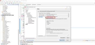

    I think the additional adding data might cause the issue, because the CCS will generate the ECC automatically for the application if we enable the below option.

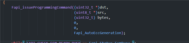

    1.We use Uniflash or the MCU with the F021 library for programming.As shown in the image below, I should have enabled the ECC-related settings.
    2. We use our own tool to parse the hex file generated by CCS and add the data we want at the corresponding locations. I was wondering if the ECC could also be added during the programming process?
    This looks fine for me.
    If you are programming like you mentioned in step-1 processes, then at parsing level you no need to add ECC i guess.

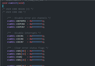

    3. Additionally, during simulation debugging, I found that after a fault is triggered, I call esminit from the HAL library to initialize the fault, and sometimes the fault clears after the setup, but other times it has no effect. Why is that
