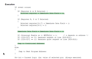

    First i don't understand how you are trying to read the PWM with below code, i think this code have some issues.
    L06   ECNT { next=L07,reqnum=2,request=GENREQ,pin=0,event=RISE,reg=B,data=2000};
    L07   MOV32 { remote=L06,type=IMTOREG&REM,reg=B,hr_data=INIT_HR_DELAY};
    ; Looping
    L07   BR { next=L00, cond_addr=L00, event=NOCOND }
    Let me explain instruction by instruction:
    As per my understanding this ECNT instruction is used to count the rising edge pulses on the Pin-0, and this instruction stores the counted pulses into the Reg-B and the data value.
    So, whenever an event occurs, first it is copying immediate data field value +1 into the register and then it also incrementing immediate data value by one. And i don't know why you keep the initial data value as 2000, maybe it will start incrementing from 2000 for every rising edge.

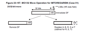

    Now using this MOV32 instruction you are replacing the data and register value of remote instruction with immediate data of this instruction.
    and what is the purpose of doing this it will replaces the counted pulsed of L06 instruction. So, pulse count might become zero, right?
