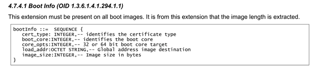

AM2431: There is something unclear about TRM "4.4.4.1 eMMC Bootloader Operation"
Part Number: AM2431
The TRM refers to spruim2g.pdf.
TRM "4.4.4.1 eMMC Bootloader Operation" states, "When the complete image has been read and found in good integrity, the ROM Code will branch to the address defined in the Boot Info field of the boot header."
I have two questions about this sentence.
- What is the "boot header"?
- What is the "Boot Info field"?
Thank you in advance for your help.
