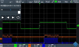

    1. cmp3 and sync delay
    This picture is the scope, green is phase U, orange is data - of the encoder, and blue is clk -. The cmp3 value is 8500. The dela time is measured between the middle point when U is low and the start point of clk -. Delta time is 18.67 us, and would increase to 24.93us when cmp3 is 11500.
    I can see that PWM and encoder time is synced. But I can't get how to calculate the difference time, increase cmp3 by 3000 should result in 15 us, right?
    Yes, correct as IEP is running @200MHz.
