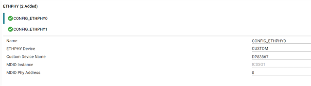

    I wanted to confirm on few points:
    1. Have you made sure that the driver for DP83867IR is correctly configured, that is, there is no mention of DP83869 phy within the register read/write?
    2. Do you see set bits in the MDIO PHY Alive Reg (0x300B2408). If yes, have you configured the PHY address in sysconfig based on the corresponding bit set in MDIO PHY Alive Reg?
    3. In the case of Enhanced Link enabled (enhancedlink_enable = TIESC_MDIO_RX_LINK_ENABLE), have you configured the link polarity correctly? If there is a bit set in MDIO_LINK_REG (0x300B240C) when the wire is connected, TIESC_LINK0_POL0/1 should be made TIESC_LINK_POL_ACTIVE_HIGH. Otherwise, TIESC_LINK0_POL0/1 should be made TIESC_LINK_POL_ACTIVE_LOW.
    4. Is tiesc_ethphyInit() in tiescsoc.c file updated with DP83867IR based parameters ?
    Aaron
  • Hi Aaron,
    1. Yes, I double checked the phy register map. I think I had to modify some entry but other than that the registers are almost identical.
    2. I'll double check the mdio phy alive register and come back to you. However, I can interact with the phys. The phy adresses are correct in sysconfig.
    3. I tested with normal and inverted polarity. The normal polarity is the correct one.
    4. Yes, I updated the tiesc_ethphyInit function and I'm configuring the DP83867IR parameters from there. You can find below the code I wrote and diff with the originial tiesc_ethphyInit function and 83869 phy driver.

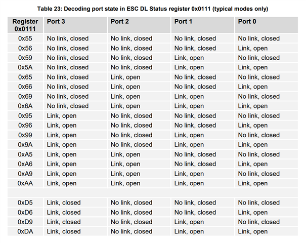

    • First time I read the 0x110 ESC register, it tells me 0x5501 (no link), however after a second read it always tells 0x5711. It means:
      o There is a physical link on port 0 (bit 4). Good.
      o Loop port 0 is closed (bit 8). This is strange, it should be open.
      o Communication stablished on port 0 (bit 9). Sounds good.
    • Please have a look to the EtherCAT ESC datasheet section 2 (Registers). On Table 23, the register 0x111 possible values are specified. I expect to read 0x55 when I have no cable and 0x56 when I plug the cable. 0x57 is unspecified value because the next foreseen value is 0x59.
    If you have some idea why this is happening, I’d appreciate to hear that.

  • Hi Aaron,
    I'm still stuck with the issue but I'ld like to share some findings. If I disable the enhanced link detection, then on port 0, it still tells me 0x5711 (link but port closed). However, on port 1, the value is 0x5921 (link and port open). I tried to scan but nothing happened.
    In addition to that, I switched the cable from port 1 to port 0 and the register 0x110 value didt not update, it kept the value 0x5921 (link and port open on port 1). Idk if its related to the enhanced link detection. I need to look more into this.
    Another thing is that, if I enable the enhanced link detection, although its written to a propietary register and so on, it does not reflect in the ESC register 0x8 (ESC Features bit 6) or in the ESC register 0x141 (ESC Configuration bit 4 and bit 5).
    I tried the TI example on the EVM and I saw the same issue on those registers. This problem does not cause the issue I'm facing but I think it'd like to report it so its fixed on an upcoming SDK release.

  • Hi Aaron,
    I'm still stuck with the problem. Do you have any update? I'm still wondering why the PRU keeps the port closed although there is a physical link.
    Álvaro
  • Sorry Alvaro for the delay.
    • We will recheck this from our side and confirm.
    I tried to understand the values but I'm not able to interpret the meaning clearly. I hope you can understand it better than me.
    • The values looks to be fine.
    • We still suspect if the PHY pins are correctly muxed to the MII instance. Give me some time to understand this issue. I'll get back to you by Thursday EOD.

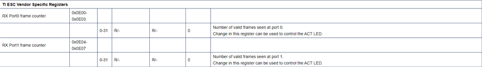

  • Following the previous message, can you provide the values observed in 0x0E00 and 0xE04 Registers?
    Aaron
  • Hi Aaron,
    The register values are 0 on both cases.
    We looked with Wireshark and we saw the 3 ECAT BWR frames from the master but not coming back with the WC incremented.
    Kind regards,
    Álvaro
  • Hi Alvaro,
    • Okay that confirms no valid frames in either of the ports.
