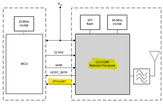

Hi Team,
Do we have AM26 + automotive-grade HCI wifi module solution?
Zane
Hi Team,
Zane
Hi Zane,
It has McSPI interface, but it's different from the SDIO which is designed as an extension for the existing SD card standard, to allow connecting different peripherals to the host with the standard SD controller. It is extensively used to connect Wi-Fi/Bluetooth chips.
McSPI has 4 signals: CLK (CLock), CS (chip select), D0 (data 0) and D1 (data 1).
SDIO has 3~6 signals: Cock, CMD, and 1~4 data signals
