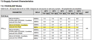

  • Hi Ito,
    I tested the current consumption under the condition you mentioned:
    • MCLK = SYSOSC(4MHz)/4 = 1MHz
    • VDD = 3.3V
    • ECL enabled
    • Active mode, runing " while(1) {}"
    And the current is around 440uA (measured by Engergy Trace):
    As I decrease the supply voltage to 2V, the current does not decrease too much (measured by voltage/resistor).
    It seems that it's difficult to meet customer's requirement of "200~250uA" active current.

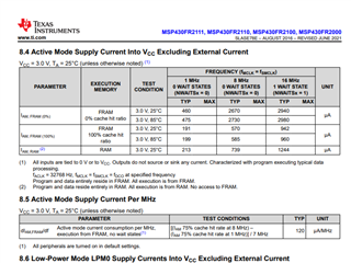

  • Hi Pengfei,
    Thank you for your reply.
    Under the same conditions, what would the current be if tested on an MSP430FR2110.
    ito
  • Hi ito,
    The current of MSP430FR2110 under 1MHz in active mode could refer to its datasheet:
    When program is running from RAM or the cache hit ratio is high enough (maybe higher than 75%), I think the requirement of 200-250uA could be satisfied.
    By the way, what is the application of the customer? Will MCU work in active mode all the time? I still think the low power mode of MSPM0 could be considered to get a low average power to meet this requirement.
    Pengfei
