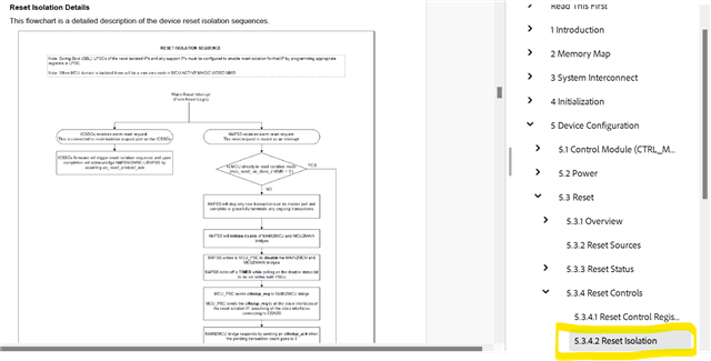

is there any example project and documentation / application note to set m4f subsystem in isolation mode for functional safety purpose?
Jinlong
  • Hello Jinlong,
    Please look at the chapters below for more details about how to Isolate the M4F core from MAIN domain .
    https://software-dl.ti.com/mcu-plus-sdk/esd/AM64X/10_00_00_20/exports/docs/api_guide_am64x/MCU_RESET_ISOLATION.html
    Next, look at the example below and  on the M4F side the above flow chart is implemented.
    ....examples\drivers\safety\reset_isolation
    So, when you do WarmReset the SOC, the Reset interrupt will go to M4F core.
    In the M4F core, we will try to disable and enable the MAIN2MCU and MCU2MAIN bridges and M4F allows the MAIN domain reset propagation.
    Please remember  that in the M4F core is isolated, user can't access the MAIN domain peripherals from the MCU domain and MCU peripherals from the MAIN  Domain .
    R5F and M4F cores run independently when they fully isolate the M4F core from MAIN domain .
    Please let me know if you still need any help..
    Anil.
