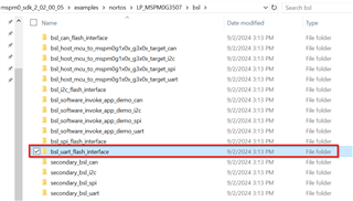

  • Hi and thanks Sal,
    By the way, for rom bsl, user could select using flash interface for using different UART perioheral with default ROM BSL.
    How and where do I have to make the configs for ROM BSL with UART1? I didn't know that this is possible!
    Matze
  • Hi Matze,
    You can refer below SDK example:
    B.R.
    Sal
