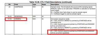

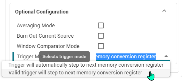

I m using Sequence mode then a set PWRDN and ENC bit of CTL0. But after convertion of all configured channel ENC is clear aven PWRDN automaticaly cleared. So Next other trig event is ignored.
Specification say:
16 PWRDN R/W 0h Power down policy
0h = ADC is powered down on completion of a conversion if there is no pending trigger
1h = ADC remains powered on as long as it is enabled through software.
see below all register berfore Set ENC bit:
