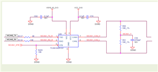

AM2634: Need to know about CAN transceiver IC mentioned in AM2634 EVM board.
Part Number: AM2634
I want to use MCAN0 or MCAN2 pins coming out from HSEC connector. Internally MCAN1 is used and its working fine.
When I am using  MCAN0 its not working,  I am using below CAN transcever TCAN1042 circuit  which is given in your schematic.
Instead of MCAN1 we are using MCAN0 (Pins coming out on HSEC).
Is this correct way of using ? or is there any suggestion from your end?
